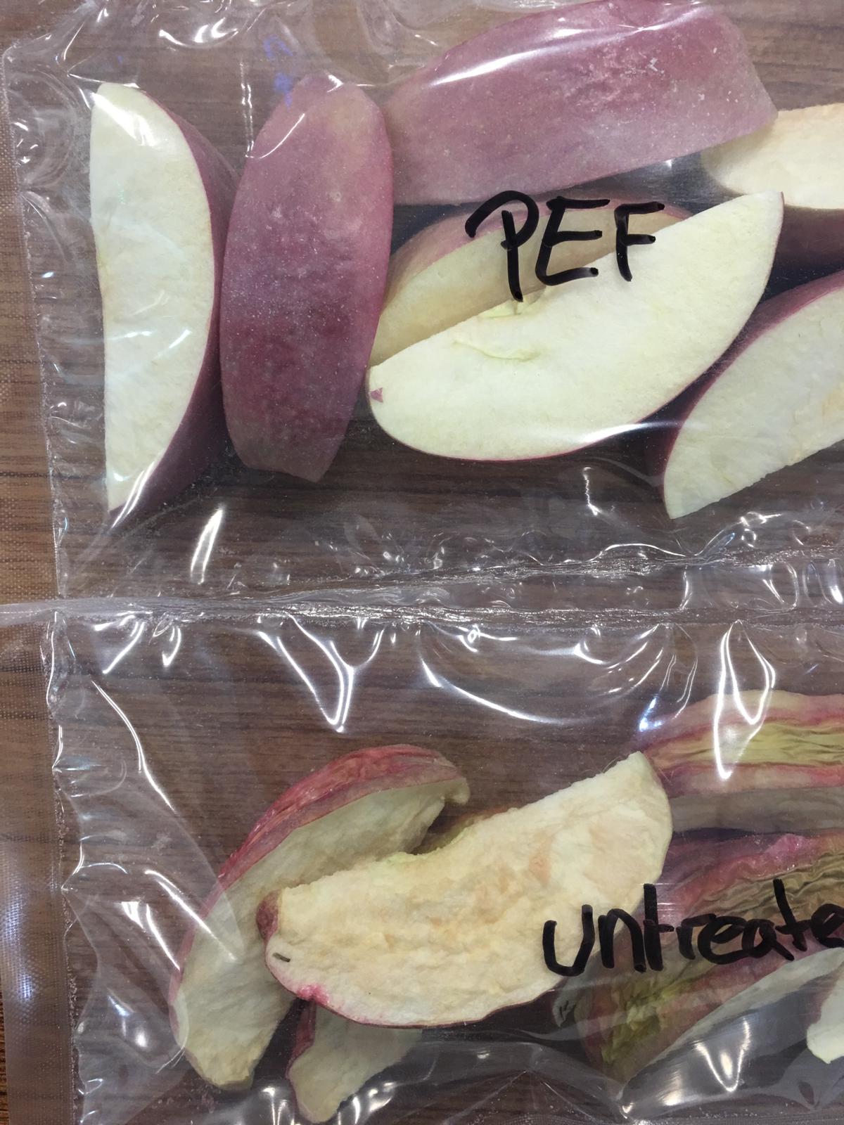

You can see the picture. All freeze dry.
Freeze drying is the best technology for drying, especially if you wanna keep the color, shape, taste and nutritional facts. Combining freeze drying with PEF technology, results are incredible. But of course investment cost and operating costs are also high.
