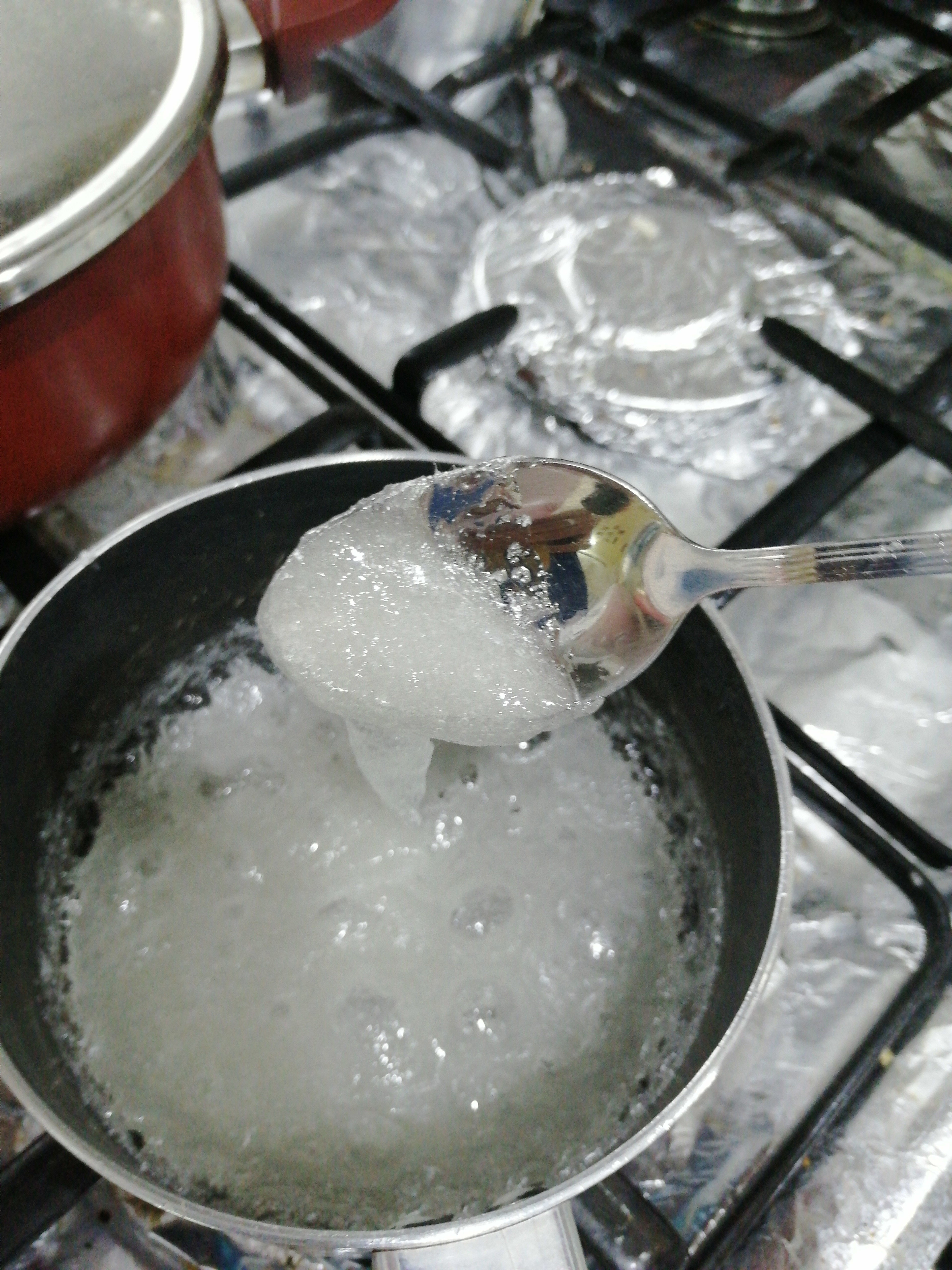

Hello good day
Yes I tried it but didn’t work
The sugar and glucose burns so quickly and it’s difficult to handle without water
Is there a certain way to cook? Or I can add water to the mix what should I do please help me

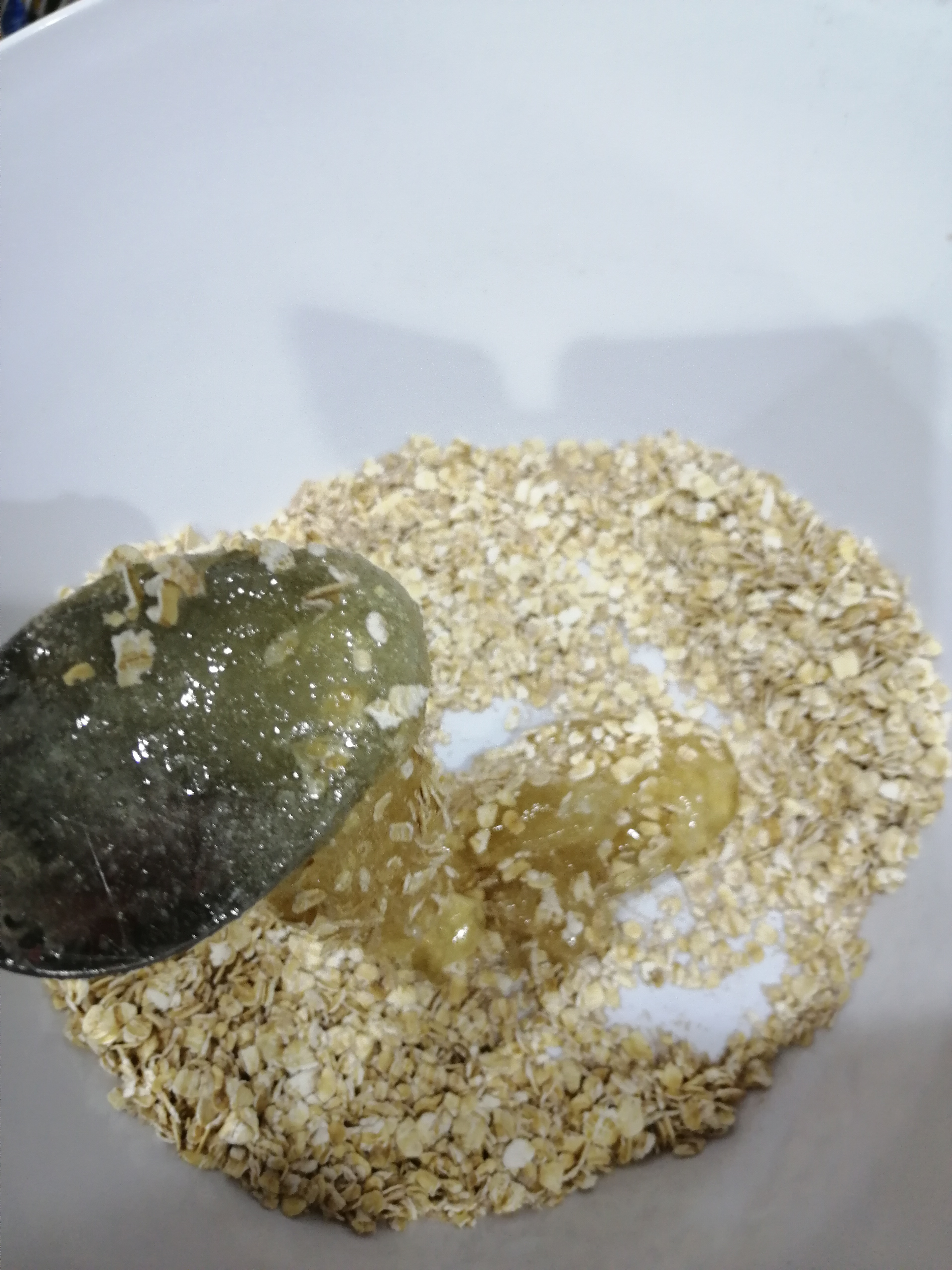

Also I tried honey but I cooked honey first didn’t measure what C degree but it took around 5 minutes then I added the dry ingredients to it
And form the bar and let it cool on room temperature
The bar texture is good but little bit hard
I used
50 g dry ingredients
40 g cooked honey
So the syrup is 90% to the Dry ingredients
true process.
90% ?. it should be 40/90 . also do not forget water content of honey which evaporated.

1- Table sugar should cover 25% of the total product. When you bring the boiling temperature to 150 degrees with 20% water to put in table sugar, add 0.015% citric acid. citric acid should be diluted with water.When syrup temperature reaches 150 degrees Celsius should be lowered over the fire.
2- Oatmeal and whey protein syrup prepared into the container prepared by pouring hot as a homogeneous mixture is provided quickly. After the mixture is provided, it is provided to cool down quickly by spreading on cold clean ground or pouring into molds.
If the product is not desired to be hard and brittle, 0.001% alpha tekoperol and glycerol may be added to the product in the same ratio. both the shelf life of the product is prolonged and the desired flexibility is provided.
