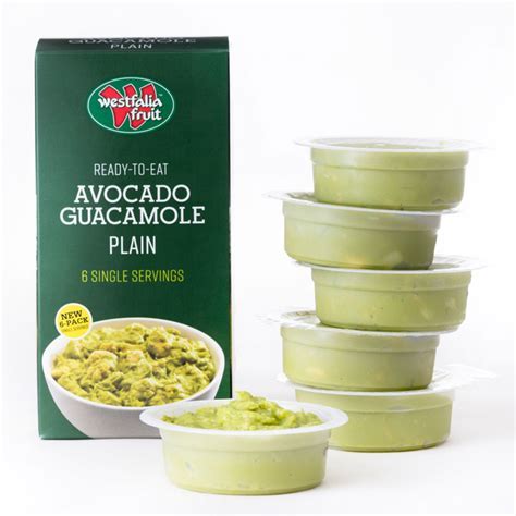

OIP
We have a company that does avacado this way in packaging.
That great. May I know what preservative/ additive used in it?
His name is Federico Gomez from lund uversity .
They use SO2 as preservative and frozen.
