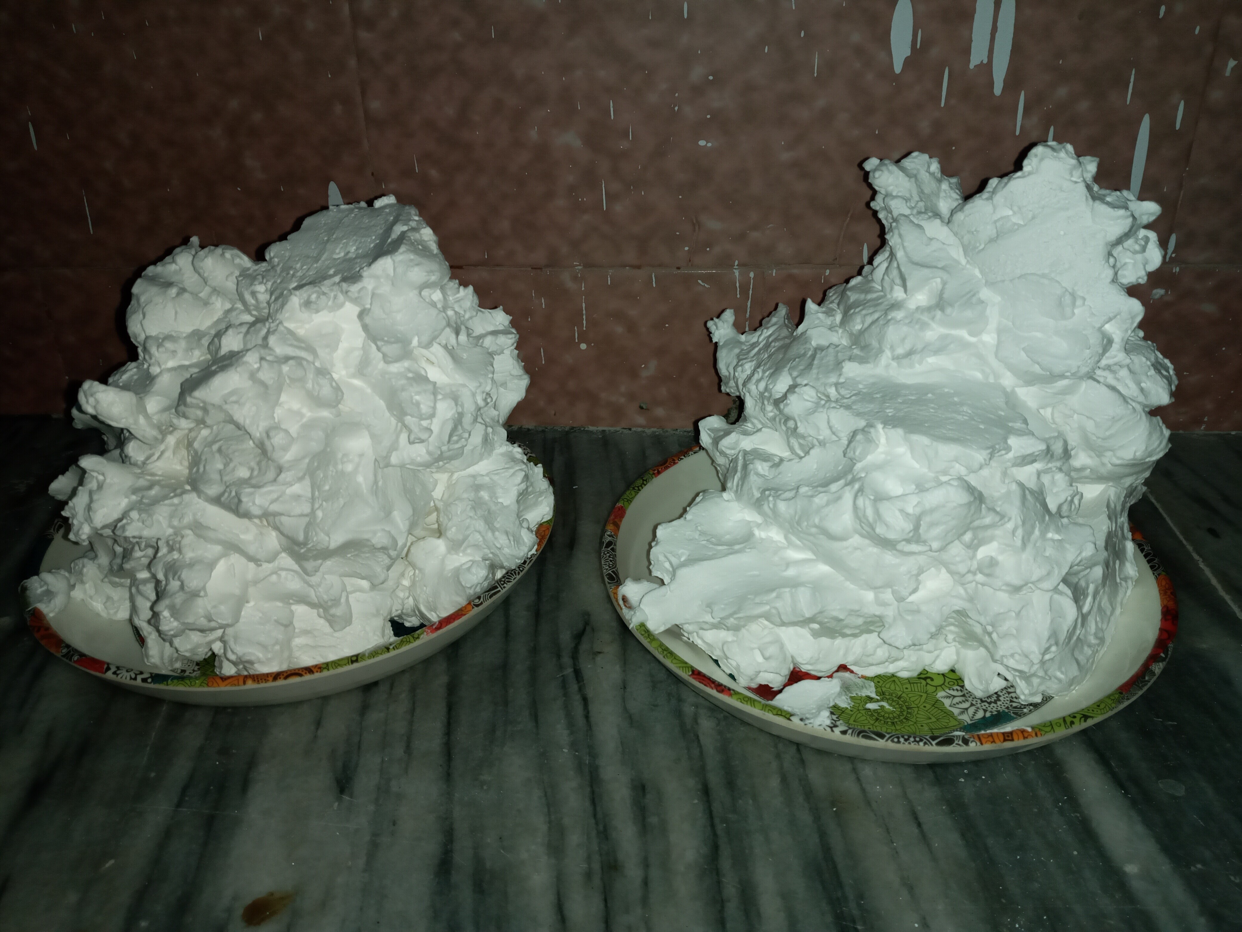

Dear Professionals please guide how to control cracks on whipping cream cake during storage in refrigerator after decoration.
And how to improve whipping ability I mean how to increase strength.
Many thanks in advance
What does contain your cream? And these images after refrigerated or?
These are before refrigeration.
Could you please share also after?
I don’t have after at the moment.
But we are facing crakes and sometime very loose texture. Please guide me.
