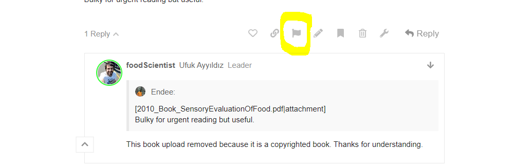

This book upload removed because it is a copyrighted book. Thanks for understanding.
If you recognised any copyrighted content shared/uploaded please flag it. Thanks.
