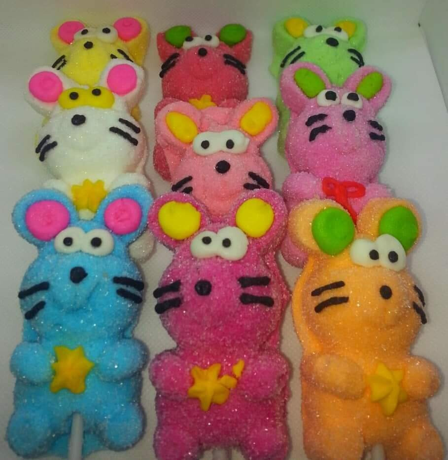

I'm experimenting to make lollipop marshmallows
My ingredients are below;
Sucrose
Glucose
Dextrose
Salt
Sorbitol
Potassium Sorbate
Gelatine
Maltodextrin
Cream Tartar
I want to get a harder and thicker consistency
It should stand more firmly on the rod
what are the your recommendations?
Thank you.

There was not enough foam in my try
has a very sticky consistency
I boiled sugar at 110 degrees
What should I do? I would be glad if you could help.

I am currently mixing to experiment. I am preparing a total of 1 kg of mixture in a small pot.
If I can get the consistency I want, I will buy the necessary machines.
I boil sugar and glucose at 110 degrees, add other ingredients and whisk
but it fades when it is full of foam and becomes creamy
dextrose powder
maltose and sorbitol syrup
I will write you their values too
A product I took as an example contained cream tartar and maltodextrin.
There was no foam when I tried this way
Is my mixture recipe or my mixing method wrong?

I tried according to the order you explained, the result is good
only the mixture gives a very strong elastic structure
cubic centimeter weight dropped by 0.60 g
what could be the reason for this strong structure

The strong elastic nature is due to too much protein in your recipe.If you don’t want reduce the milk powder, cut the gelatin quantity by half…
Both gelatin and milk powder when dispersed in water become foaming agents during the whipping process…
Normally marshmallow does not contain milk powder ,but you need it for the milk taste it can confer to your confection.
Test it get Brix readings again …
