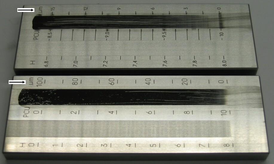

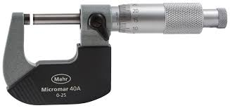

I have used both previously; micrometer caliper and Hegman Gauge or grindometer…
i have not used grindometer but i guess it is better then a micrometer especially for chocolate? Am i right?
nice technology
Actually it depends upon the skill in using either devices .But I find Hegman gage to be more accurate…
Micrometer will provide with the biggest particles size.

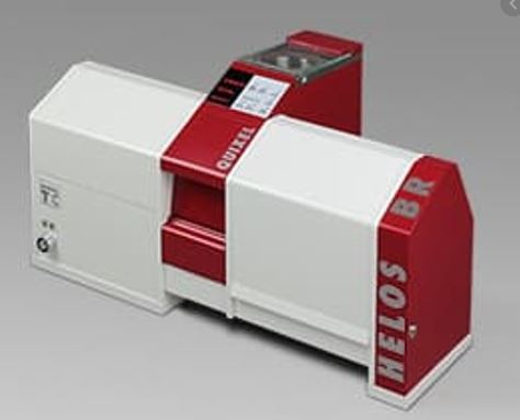

The more efficient is lazer diffraction
hi everyone ı used micrometre and PSD (particle size distribution). this insturments are very important for chocolate industries. both of them very usefull. when you want to use PSD and you can take percents of results your targets.
psd
ı think which one is better ofcourse PSD.
PSD is nearer to the old fashioned Hegman gage than the micrometer as the hegman can show particle distribution by manual means.Unless your business is huge you can’t invest in very expensive Sophisticated devices using electronics to show results.
