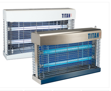

basically, you can use electrical EFK fly killer and many food company are using that. it can be very helpful for you.Ekran Alıntısı.PNG
It will be expensive…
