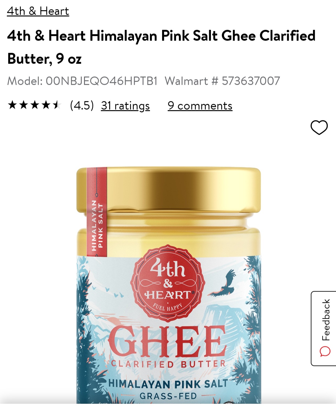

Can anyone throw some light on how this product is manufactured without using any emulsifier? How can this product be stable during storage? They are just using ghee and Himalayan pink salt.
For the overrun of Butter, Salt is being employed. Then butter is clarified as ghee. So I guess that the added salt could be Himalayan pink salt. Just my guessing. Correct me if wrong
The salt IN POWDERED form is added is not more than 2 % to the prepared ghee. and stir until its starts to solidify ,then pour it in semisolid or viscous liquid in bottles so you will have your salt in suspension.
So in this case, there is no requirement of high end machinery to mix it right?
Try it in the kitchen, then when you succeed and understood the process, that’s the time you scale it up with factory equipment.
