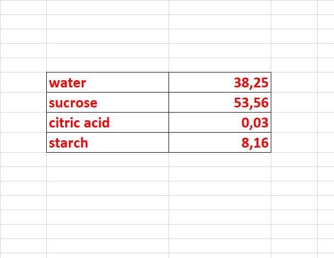

Hi All,
Please imagine a product with below recipe;
Mix this ingredients in a open cauldron, cook the mix until 120 C about 2 hours with continuously string the mix.
After finishing the process what can be inversion rate of sucrose in the product?
any idea would be very appreciated.

In fact this question is about Turkish Delight ( Lokum).
My friend said me that; she sent a producer’s delight to a lab to analyse invert sugars content and the lab result says 50 % percentage of total sugar is invert sugars ( glucose + fructose + maltose ).
But the producer says we do not use any invert sugar for delight production.
So we wonder invert sugars content is a result of inversion or producer is lying
